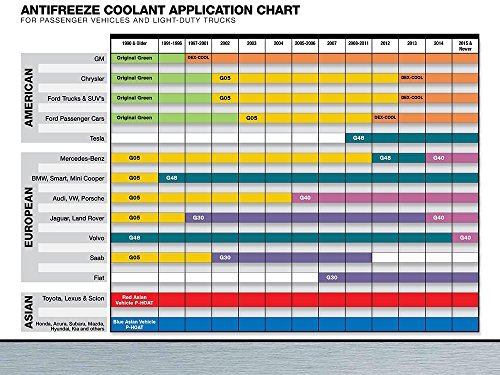

Someone screwed the pooch, you are gonna need to flush that thing like 4 times with OAT. Does your truck take 10 year or 5 year coolant, from owners manual?
Burla
Apr 28, 2012
27,743
58,186
2010 Hemi Reg Cab 4x4
Three main types of coolant, IAT, HOAT, and OAT. The two that are the worst to mix are IAT with OAT, but none play nice with each other. It is a huge effort to flush, as the drivers block bolt is near impossible to remove. You should flush a bunch of times, and from here on out flush yearly with at least a couple gallons 50/50 water plus what coolant that takes, likely OAT? Your year was right on the change date so it can be oat or hoat, you need to look it up.

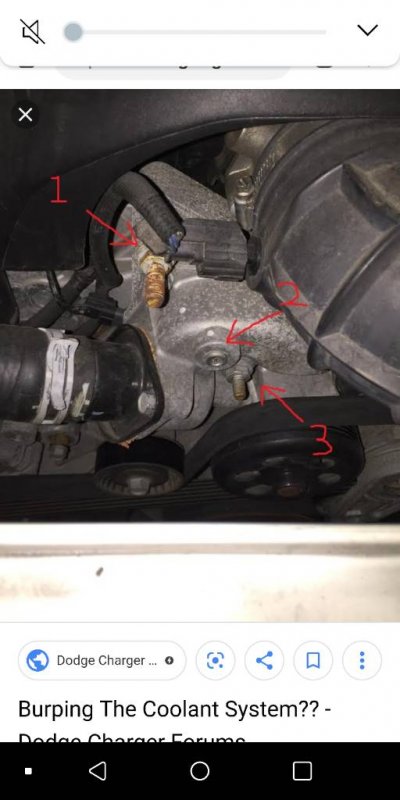

Next to the thermostat housing is a allen bolt that you remove when filling the coolant system. It helps a lot with air being trapped in the system.
Sent from my VS988 using Tapatalk
filling and emptying, take it off before draining and don't put it back til you fill it.
