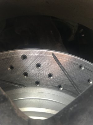

So this is one of the front brake rotors, it has this line going around it. Keep in mind I just put them on this morning and only put about 25 miles on them. I didn’t know if that was a sign that there was something stuck between the pad and the rotor.
If you run your nail across the line does your nail catch against it? Or does it smoothly slide across?
Do you live in a area with a bit of gravel?

Well that's actually weird that it even goes over the holes.. If it was a peice of rock you would think the hole would catch it and bust it loose or it would fall through the hole.

Do you hear any noise from them presently? Whatever caused the line could be gone by now. Only way to tell is pull that pad.
Yeah I can feel it with me nail already:favorites68: there is a moderate amount of gravel...as well as asphalt haha. I’m not off-road ever really.
Right that was my thought. I guess I’ll just keep my fingers crossed it’s gone.
Would it help at all to take some high pressured air to it to see if I can blow whatever it might be out or would that be pointless really?

I would think compressed air wouldn't hurt anything at all. But as @ThunderMug95 said the best way to tell would be to look at the pad and see that spot.
I wouldn't think this is possible but brakes have some serious hydraulic force. Maybe depending on the material of the pad maybe a little rock is pressed into the pad?

I’ll try hitting it with some air tomorrow but if I can feel it with my nail than hasn’t the damage been done already?
