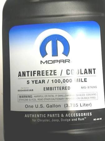

cooling system 80 but don't do it unless they will use Mopar Hoat, make sure the bottle says 5year 100k. Do not let them talk you into it even if you have to bring your coolant with you.

Use nothing else but this stuff. By pre-mix costs a little more but it's worth it to get the % right.
A quick question about the coolant. What is the difference between Mopar OAT coolant and other name brands of OAT coolants?
The reason I ask is about a month ago I switched to a 180 t stat and lost about a half gallon of coolant. So I went to my local auto parts store and bought a gallon of a different name brand premixed OAT coolant due to the fact that the nearest Ram dealer is about 1 1/2 hours away.
Is it OK to do this long has it is a OAT coolant or is there something different about the Mopar OAT coolant that our trucks need? Link bellow to the OAT coolant I purchased.

Different additives, you can see that is a 5 year coolant. At least it isn't dex, but there is a ton of stuff out there that coolants don't mix, and considering the cost of failures, I'd just opt for a flush if I were you. Use distilled water, then I think you only need two gallons Mopar as it mixes 50/50 with distilled. A lot went into the new Chrysler coolant, search the forum for coolant and read the links. The links explain some of the difference between Oats, at least dex and Chrsler Oat.
