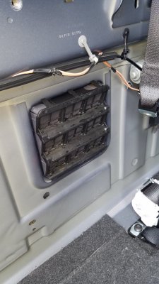

If you have never checked under your rear seats where the floor meets the back cab wall after a rain storm then you might be missing out on finding wet spots!!! Been aware of the third brake light leaking since my 2013 ram and thought i had fixed it on my 2018 but awhile back we had a big storm and i thought i would check under my rear seat. I had not been checking as regularly since i had got the leaking stopped at the light. Well damn it that carpet pad was wet again and i was confident that the 3rd brake light was sealed. Read around on the fourm and saw that the rear exhaster vents in the rear cab wall can leak so i pulled the seats and rear wall pad and sure enough they had puddles on top of them. They were very loose and could move around easily. I removed them and cleaned them up. They are tricky to put in from the outside since you can't get your hand up between the cab and bed so i stuck them back in from inside. You have to turn them on there side to go thru then rotate and pop back in. To take up the play and make them fit tighter i wedged a strip of cardboard across the top behind the three tabs and pulled thr whole vent down and made sure it were seated at the bottom then taped it down with some aluminium a/c tape. They are now tight to the wall with no play or movement and no leaks from me hosing them down , ready for the rain!! 20200429_115429.jpg 20200429_154621.jpg

Yeah these vents are a pain..
Problem is, they're basically like check valves and with them mounted backwards, they're not going to relieve cabin pressure and they're going to let noise, dust, debris in I'd think?

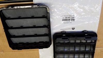

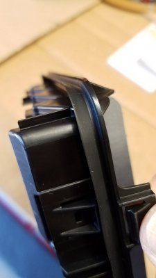

I did some searching for new vents too. I ended up buying some new ones after reading that there was a newer version. The pn# 68323649AB seemed to be the latest pn# and covered my 2018. Picked them up at FactoryChrysleyParts.com for $4.98 ea plus shipping which was $11.14, total was just under $21.00 . Ya i know shipping was high but it came out the cheapest of all the places that had em on the net. Just got thru installing them and they fit tight and no leaks. Now to put it all back together. 20200510_120703.jpg 20200510_120723.jpg 20200510_120723.jpg

I did some searching for new vents too. I ended up buying some new ones after reading that there was a newer version. The pn# 68323649AB seemed to be the latest pn# and covered my 2018. Picked them up at FactoryChrysleyParts.com for $4.98 ea plus shipping which was $11.14, total was just under $21.00 . Ya i know shipping was high but it came out the cheapest of all the places that had em on the net. Just got thru installing them and they fit tight and no leaks. Now to put it all back together. View attachment 206693 View attachment 206694 View attachment 206694
So, is there any seal or gasket? and any tricks to replacing them?

I picked up two new replacements for mine from the local Ram dealer for $13 out the door. I was planning to buy them online, but even with the slowest and cheapest shipping option, it was going to be $30. If anyone needs a replacement, check your local dealer.
When I installed my new ones, I put a bead of 3M 5200 fast cure marine sealant in the seal that seats on the outer wall of the cab, and then another bead at the seam where it meets the wall on the inside. I sure hope I never have to replace them again, as it is going to be a real pain to get them out, but they ought not leak.

Hey just a word of advice, I wouldn't use 3m 5200 as it's used for permanent adhesion. If you ever have to change that filter it's be a nightmare trying to remove it and the 5200. Using 4200 is definitely better for the job. Just trying to help out as I've used both for boat projects and have tried repairing items on others people's boats that had used 5200 instead 4200. Not fun and near impossible to remove.

No doubt. We used 5200 offshore to stop a seawater leak, lol. That stuff is an absolute nightmare to get off once it’s cured. On a bright note, I most likely won’t have the truck long enough to need to replace it. If I do, I’ll cut it out if necessary. I just wanted to make sure it didn’t leak.
