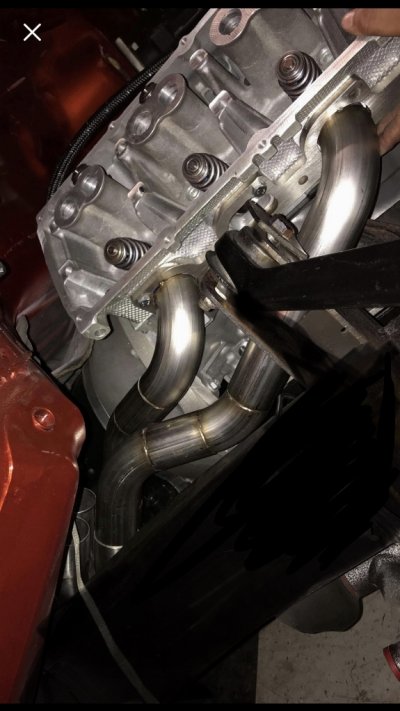

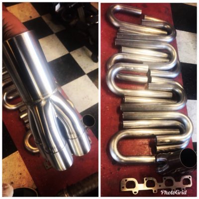

Not much of a update but finally going to the shop to get the custom stainless steel headers made, and exhaust bolted on. He said he would need a 3 weeks ;(

Two inch!? Dayum, dude! How much do they really need to flow if you can't boost that motor!?

468ci plus nitrous should be around 900+ crank. I think 2” will do good. All the fastest 449-468 NA car that are running 8-9s NA are using 2”
