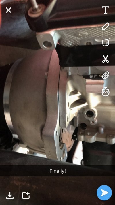

Is the engine running at this point or still needs finished? Congrats on your trans too

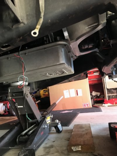

Awesome buddy!
Which pan did you end up getting. I want to swap out the factory steel pan for an aftermarket one with a temp sensor **** in it and keep looking at a bunch of them, obviously the 4L80e aftermarket is huge compared to Dodges, lol.
I Bleed Ram Trucks
Motor has been done for months just needed the trans and do all the wiring, and headers.

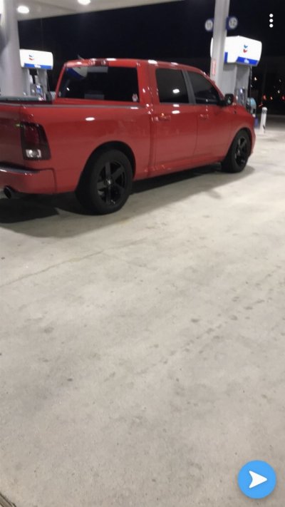

Got the Daytona Tow pig sitting right and ready for some towingher day for towing is coming.
