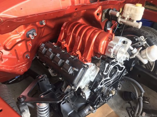

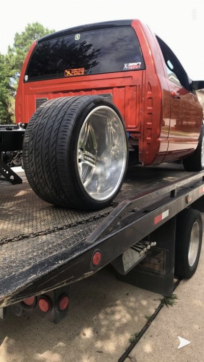

Sorry guys for no update. She has been taken to a shop to get finished. Being summer my boys keep me busy. Here she goes getting towed and have been told 3-4 weeks. So that will have her running by the end of this month. The shop is going to clean up the engine bay and basically eliminate every wire that isn’t needed. I’ll be taken more pics this month and more updates.
I do plan on ordering my rear bogarts end of this month just so I can bust ass to make a mopar event and get her dialed in. I do t expect a PB but hope for great time with the opportunity to improve for some record breaking ET.
I did however change the color of my intake to color match vs before was hemi orange. 3d50d9441f0bacfb293151ac5c048634.jpgac009259ba6cc0d88a9e54df125c9de4.jpg

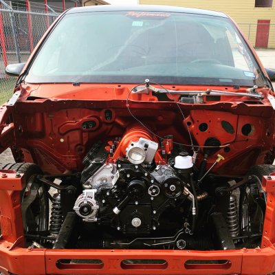

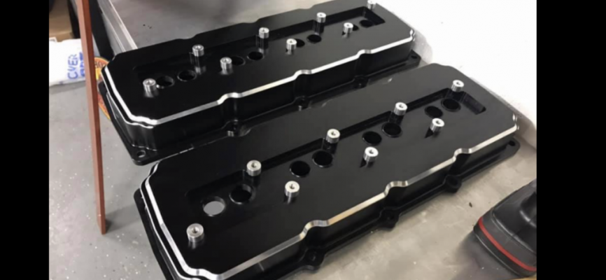

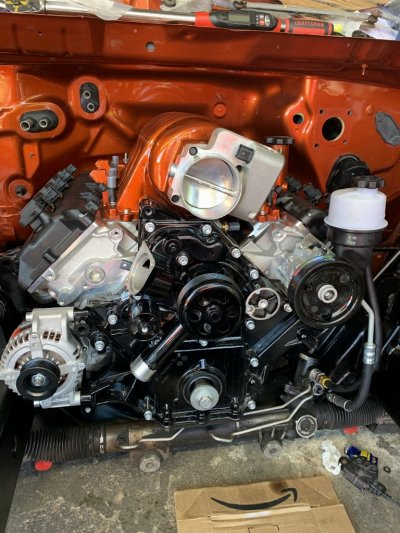

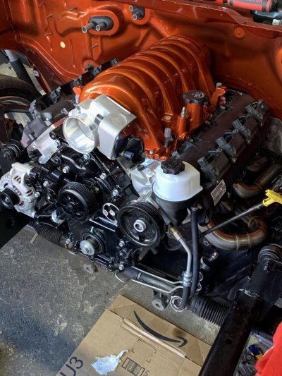

Not much to update but The motor and transmission are installed and sealed ready to fire up. Unfortunately the shop I took it to to finish is taking there time since I’m requesting a lot of detailed custom work. I’m installing all new brake lines they must bend and install. Tucking and hiding all the wires, redoing all my fuel system, I ordered new billet valve covers since I’m doing a lot for the shows as well. Sorry for the delay but guarantee you guys won’t be disappointed when she done in the performance and looks department. I did get all the custom sized hoses to fit a ladder power steering pump from a LX, that alternator is a one wire alternator.
