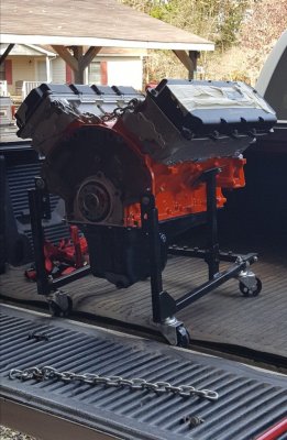

Looks great! I finally got the 426 home a couple weeks ago. It'll go into Red or perhaps my 56' Willys.
Sweet man! Put her in the red! I want to see more fast 3rd gen. My friend is detaching for a Bee or Daytona to throw his built 46re and 6.4 stroked to a 448 with apache heads and spray. So hopefully houston will have 2 10 sec NA rams then hit them with spray for some 9s. Your 426 with boost will be sick as well and low 10/9s as well

Ric, I was thinking you haven't been paying attention... you know how I spend my money. lol

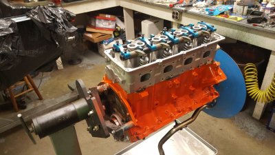

I'm using Stanke shafts and girdles. The covers are close and I have to take special care to line up the spark plug holes to the heads. Stock covers don't fit..
I’m using the same thing so I went with 6.4 oem covers but then found a deal on the billet covers. Going all out as well [emoji1598]

Didn’t u feel the stanke shaft was heavier than stock? Mine is chromoly but felt way heavier
They are heavier, oem has a wall thickness of .187" and Stanke is .250" if I remember right. The various manufacturers have .200", .250" and .300". My memory is shot so to be dead accurate I'd have to look it up. When I was researching it I found the accepted reason for the oem being flexible was because the engine is assembled by robots and needed the shaft to flex. The way I installed the retaining collars required some clearancing to clear the rockers. Another method is to use bushings to stand the clamps off from the side of the rocker. I also used 3/8" push rods. And reverse flow lifters..

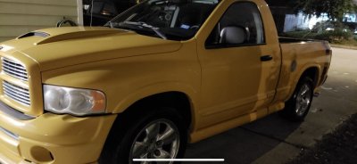

Hows the truck coming along? And what did you do for an efan? That radiator doesn't look like it had the top mounting tabs for the flex a lite fan
It’s coming! All that left is wiring still and brake line and minor other cosmetic ****. I have got to the efan yet.

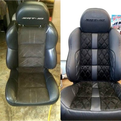

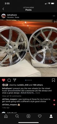

Got my seats and some new wheels atleast. Making my 4th gen faster as I wait. [emoji23] should be a 12 sec daily crewcab
