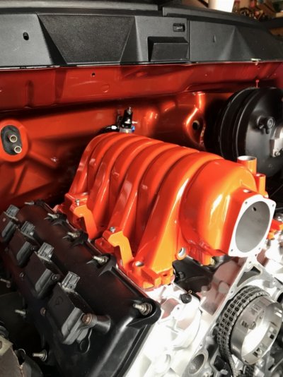

Check out my new Aluminum 468 for my Daytona
Lethal Hemi
Lethal Hemi
Apr 8, 2013
682
393
2005
5.7L
5.7 stroker, ocp intake, 90bbk, bv heads cnc'd w/m, a/w cooler 3200 stall driving a Martin Saine 46rh, manual valve body, aluminum driveshaft with a ddt 4:10 gear. Vortech V7-Sci sc. Body is stock except for mini-tub.

What heads are going on that 468?
I'm starting a 441 build , block# P5153898 4.125X4.125 with Apache heads , .937 Keyway lifters and T&D roller rockers, .710 lift cam drag pak intake for customer.
Same heads! I can’t afford thitek heads but soon I’ll get some. So for now I’m using apache
What is that motor going in?

05 Magnum, Converted over to a 4 link rear, runs a 904 transmission with the 420in (6.1) that's in it now, runs 10.80s on a good day , NA with Ritter intake and 6.1 heads. thing is gutted ,caged purpose built racer.
The New engine will get a727 behind it, hoping for Mid 9s NA
Nice! Good luck man! I’m just hoping for 10.5 Na but I won’t fit my interior. Now if someone wants to call me out then yes I’ll hit her. But at most I’ll remove my passenger seat since it take like 5 min.
I see Greg magnum running 9.2@148 NAwith a 468. His is super light as well. I be telling this guys that lighter is faster
