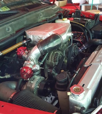

Nothing much, just changing it around a little. Did coil overs in the rear. Still need to install the fronts. Went to 8 rib, but think it could still be slipping some although it is datalogging 14psi. So been working on the cog belt. Its slow going since I work alone out in the sticks. Piece by piece..

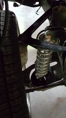

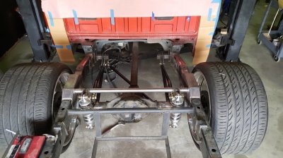

Oh I agree I also have laddercar and dual adjustable coilovers. But even with a 5.7NA will benefit with coilovers. Well atleast a well modded 5.7NA IMG_0422.JPG

Oh, nice. 2 q's.
1. On my stock truck, I can't find any suspension connecting arms. It seems as though the axle is only attached by the springs, shocks, and drive shaft. Is this the case?
And 2. What is your equivalent drop level? 4/6? More?

Yes your right about the axle! My drop on leaf springs was a 5/9 but I haven’t adjusted the coilovers just yetIMG_0662.JPG this is my front

5.7 stroker, ocp intake, 90bbk, bv heads cnc'd w/m, a/w cooler 3200 stall driving a Martin Saine 46rh, manual valve body, aluminum driveshaft with a ddt 4:10 gear. Vortech V7-Sci sc. Body is stock except for mini-tub.

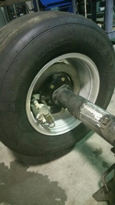

IMG_0391.JPGeven did a 15” rotor caliper conversion to fit some 15x13 or 15x14
