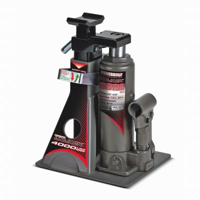

I got me 2 of these, a little bigger then bottle jack but fits in my truck. Jack stand and jack allinone.
Now that is baller! I'm Going to have to get that. I like how the base is big too!

I got the same thing in 3 ton version. I always put in truck when I am traveling ne big distance. I always also carry a Breaker Bar with 22 MM socket (for lug nuts), stays in truck all the time and put my Ft Lb Torque wrench in truck when I travel also along with small tool box with choice items, and a shovel when I travel. Old force of Habit.
