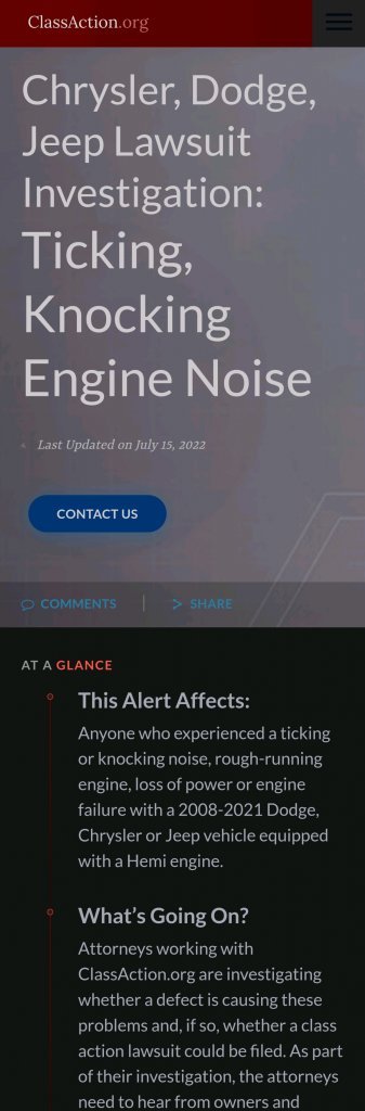

Not sure if this is the same class action. This one is asking for peoples experiences to add to litigation to start a class action i believe.
