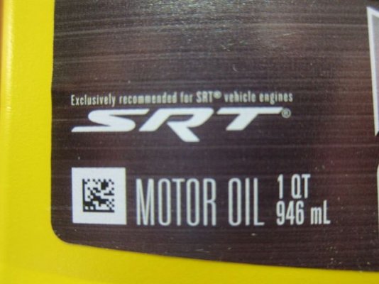

What is "SRT hemi specific oil"? Do you mean PUP? Thx
Burla
Apr 28, 2012
27,667
58,021
2010 Hemi Reg Cab 4x4
pup 0w40
quickster2
Oct 16, 2017
472
511
SE Michigan
2015 Ram Laramie 2500 4 X 4
6.4L
Thx that's what I understood as well. I use PUP in my truck at a 5K OCI and WIX XP filters. Since I need to reorder filters probably go with a RP this time around. I also used PUP in my GEN IV Viper when I had it. I was told PUP was better than Mobil 1 (additive package) which was the factory fill for the GEN IV. PUP was the factory fill for the GEN V Viper. For the track or extended spirited use most went to 15W50 Mobil 1.
