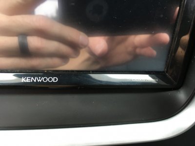

Looks like the after market radio is a DDX574BH. The first picture shows the Climate control cluster. I was going to take the cluster off this afternoon and see if any of the harnesses are loose or disconnected. Thanks for your help.

Ok in the system you have the actual heater control module is integrated into your control knobs. There is no separate HVAC module in that system. There is no way to determine if your new radio us somehow affecting the system but it's obviously connected to your trucks CAN system or it wouldn't be able to display what settings your HVAC is on. There are probably a few things it could be. I recommend pulling the bezel off and checking all the connectors on the back of the bezel ect to make sure they are connected. Disconnect them and check to make sure all the pins and sockets are ok. They may have left something off or possibly a bent pin or damaged wire. If that all looks good you can use the Alfa tool to check for DTC codes to see if it may point you in the right direction. You can purchase the bezel you currently have extremely cheap because a lot of guys including myself have switched over the the 8.4 radio with a different bezel so there are a lot of used ones floating around. In any case you should be able to pick one up for $50 or so on Ebay or Car-Part.com. they make a 4 speed and a 7 speed fan version of that style so if you try switching out the HVAC controls make sure you get the correct one. Yours appears to be a 7 speed. Lastly if you still can figure it out I would take the truck to a good stereo shop to see if everything is connected correctly. I honestly don't know if or how it could affect the system but I've pulled a few aftermarket radios out for people and replaced them with the 8.4 Ram radios because they were tired of the issues.
