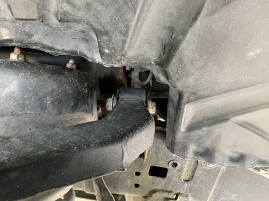

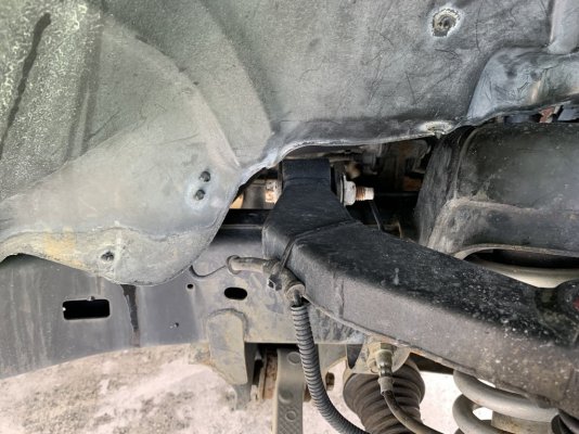

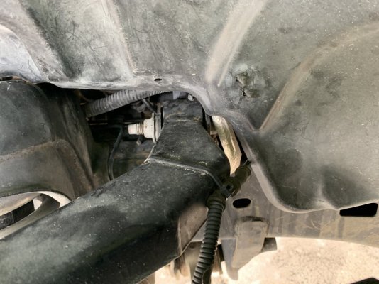

Been chasing a clunk sound for a couple weeks or so. Have not found it but found 1 thing that may be my culprit. So it feels/sounds like metal to metal shifting and tapping each other but it’s not fully repetitive to where I can duplicate it by any one scenario. It happens when the truck weight shifts from side to side usually when turning either in forward or reverse and also when going across uneven road. Rear control arms and sway bar are tight. I tried playing with the rear axle and moving the tires around. There is a very minor thump from the rear axle bearings when forcefully rocking the truck side to side but no dragging. However. I’ve already taken the whole front end apart and struts and ball joints look good. I did just find today that my passenger side upper control arm seems to be contacting the frame mount at the rear bushing. Looks like the bushing slid somehow or is worn down. First 2 pictures are passenger front then rear mounts. Last 2 pictures are driver side front then rear mounts. If I move the truck there is space again at that mount. Time for new UCAs? Not trying to just throw money at it.

Wait, these are the Zone UCAs?
Yup. I’ve had them for 30,000 miles and never noticed them touching the frame mounts so this is new. It’s close on the drivers side to touching. Thinking about pulling them and ordering the icon delta set but don’t want to spend the money right now.

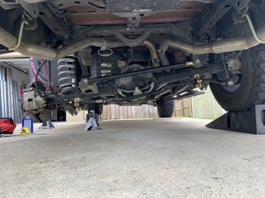

Clayton control arms and sway bar rear with core4x4 sway bar links. I didn’t notice it before and I’ve had the full setup for over a year now. But yea. You’re describing similar circumstances. I’ll try pulling my rear sway bar links and drive for a while and see if it makes the noise still

Yes definitely not bump stops. Lol. Had to play with my truck. Measured 11” rear travel with the rear sway bar connected. Still had more to compress on the passenger side but the sway bar was not letting it flex more.

@crazykid1994 have you ruled out CV axles body roll and turning side to side is how you check CV axles and often show those exact symptoms

I feel like if it was the UCA’s you could easily replicate the problem

I’ve tried doing the body roll while driving down the road and I’ve even used 4wd with no issues or odd sounds. I even crawled underneath and shook the cv axles in/out and up/down with nothing noticeable. I’ve lifted the front and turned the tires by hand as well. I thought the same thing about the UCA but I can see where it is contacting but it is weird because sometimes there is a gap and sometimes it’s contacting so I know it is shifting but not entirely sure why or how. I’m probably going to pull them out completely to inspect the bushing and see why it’s contacting in the first place. Wish I had some other UCAs to toss in temporarily to see if that is the issue. Thankfully I can pull the UCA out without fully disassembling the front end again
