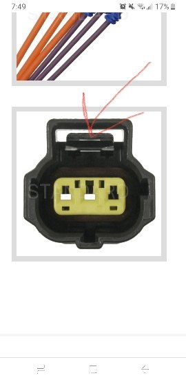

Hey all,
Wondering if anyone else doesnt have red clips on their ignition coil packs wiring harness? From what I have read, there is suppose to be red clips that you push up and then a pin you push in to remove the clips. I don’t have any red clips and don’t see and clips to push to take the clips off. I have a 2011 Ram 1500 5.7 Sport. Anyone know how these come off? Sounds dumb, I know.

Some years they didn't have those red retainers you have the s-2087 plug. You basically have to grab the back of the connector, you can kinda see a tab in the middle and squeeze (sometomes push in) till you hear and feel it pop. If that doesn't work sometomes you can take a 90* pick and unlock it by going in from the front.
In the pic you'll see that square hoop thing squeeze behind that. Sometomes the older trucks just don't like letting go easily. 21ffa50078975c894d5b89975f9b534d.jpg
