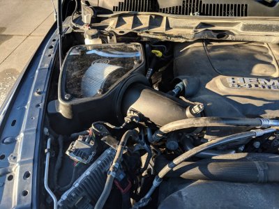

I purchased a used K&n off this forum and installed on a neighbors 6.4 2016. The only issue I had was they have a MAF slot that I had to make a custom blockoff plate for as my neighbors 6.4 didn't have the sensor. I also see it in the AFe posted here... look at the bottom side facing the radiator. 2 bolts and a 1/4"x2" slot. They show it plugged with a sensor in the installed pics but my neighbors truck didn't have it. It's a 2016 3500 mega with the 6.4.
