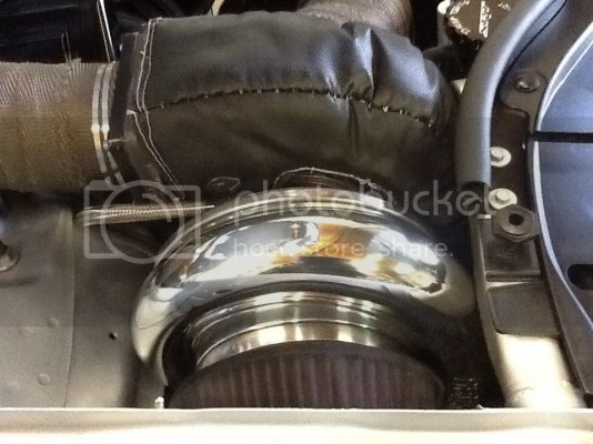

By yourself a pipe bender and a mig and alot of beer. Doing front mounts on something never meaning to have a front mount eats up a ton of time.
Front mount 88mm in SRT Jeep
