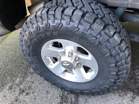

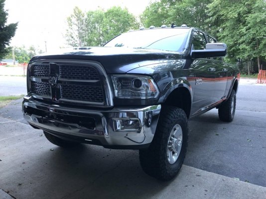

I have these tires (although 35x12.5/17) on my ‘16 power wagon. I run high 50’s in the front and high 40’s in the back, unless im towing heavy them air up the rears a bit.

I have these tires (although 35x12.5/17) on my ‘26 power wagon. I run high 50’s in the front and high 40’s in the back, unless im towing heavy them air up the rears a bit.
So if it says the max PSI is 50, does that mean I should be fine with say 45 front and 40 rear? I'll rarely haul anything with much weight in the bed if rarely.
yea you could start there and then see what its like. You shouldnt need max psi most of the time.
My 35x12.5’s are load range e with a max psi of 65. Seems weird the 315’s are load d and 50 psi max when its basically the same size tire.
