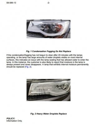

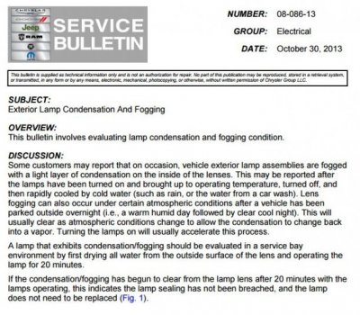

According to Chrysler some moisture build up is normal and it is. Especially if there is a sudden change in temperature. The litmus test is if the moisture goes away in under 20 minutes with the high beams on. There is even a TSB for that. Not saying I agree, just that's the policy we have to follow.

I never said I agreed with it. As a Chrysler tech I'm just letting people know what I know in order to help them.
If the moisture is still there after 20 minutes with high beams on then even according to Chrysler there is an issue with that light.
Unfortunately it doesn't really matter to Chrysler what you or I feel is excetabale. They get to make the calls.

Does anyone even try to use the "search" feature anymore? ...lol. Actually, if you used Google you would return a bunch of threads about this for that last 4 yrs with the oem projectors. My 2014 Sport did it and my brand new 2016 Rebel also did it. It's states in the owners manual about the condensation ("fogging") in the projectors being "normal" and there is even a TSB about what defines "normal" and "acceptable" fogging in the projectors. There are 3 vents on the back of the housings that are usually slammed tight by the factory and the 1st step is to open them up as far as you can without them falling off. People have had them replaced under warranty only to have the replacements fog up too. It's a ****** design and I completely agree that they should not do it. A couple yrs ago I started a thread about a method I do that keeps the fogging under control for at least a year at a time. See the link below.

Here is the TSB for the fogging...
