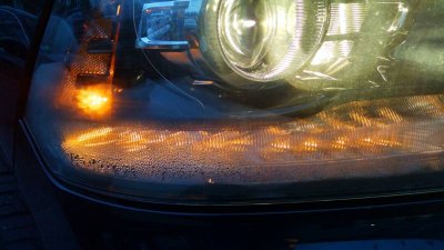

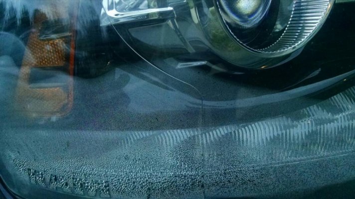

Just a update. Filed a case with Chrysler. Of course they denied it. Said the tech says it's normal so it's normal. I just did what the TSB said to do and the water is still there. Turned the high beams on for 20 minutes. I waited for 30 minutes. This is what they still look like.

That's not normal though if it's like that after 20min. Your dealer is just being difficult, have you tried another dealer?

Ok. Then if it's normal both headlights would look like that. The drivers side doesn't have any condensation at all. That is where I call ******** on Chrysler. We all know that there is something going on with the seal on that light. Chrysler level of what's acceptable to me is "unacceptable". It looks like **** and the moisture never goes fully a way.

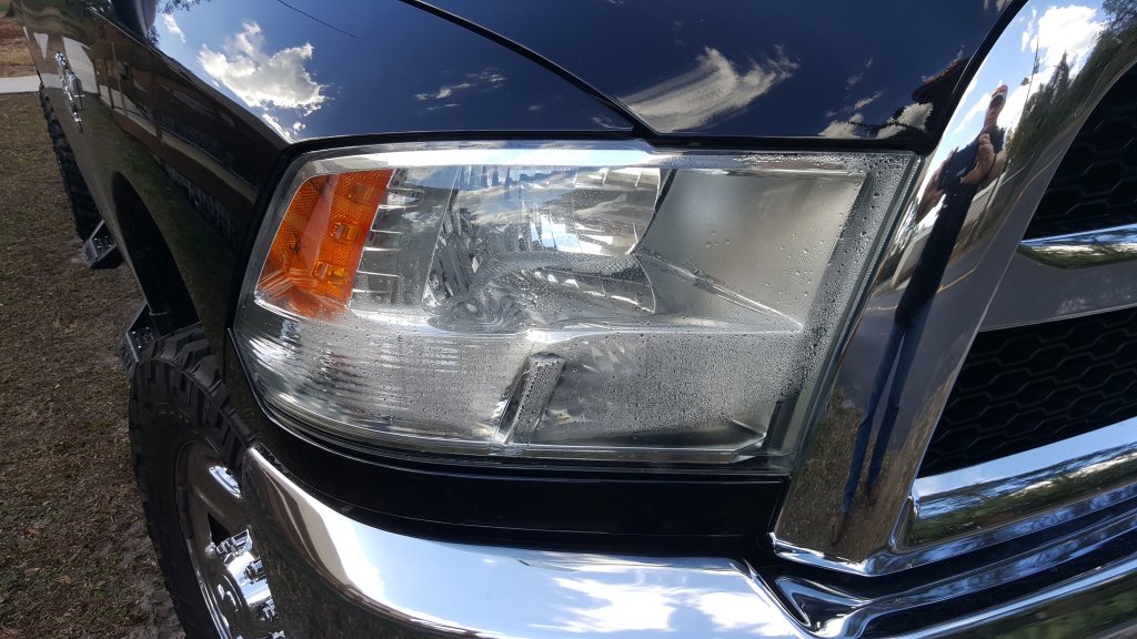

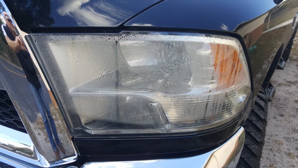

I got this 2015 used last year in July. The headlights have had some sort of condensation in them 100% of the time. These pics I just took and this is one of the better days.
full
full
I have tried to take the turn signal lights out and let it sit in the sun for a few hours, but all it does is reduce the moisture, then in the evening it's back again.

I have a 2015 that i bought last Julyish also! I kind of half-a**ed the silicon fix and just seals off the vent holes all together. Confirming that was a bad idea and didn't work haha. I did notice that those vent covers were pushed all the way in when i took the headlight housing out. Going to drill those vent holes back out this weekend and try just leaving them off and see what happens.
