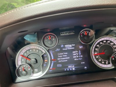

ts27330
Sep 13, 2014
56
42
V6 3.6
Pentastar 3.6 2014 readings attached, in NC. I use full synthetic 5w-20w.
