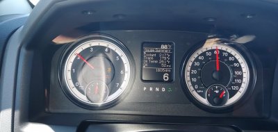

Mine after 1.5hrs of pulling my 28ft camper.
Nothing wrong with 219 really imo.

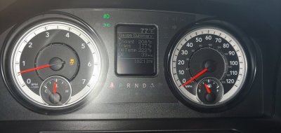

And a pix of just normal driving temps.
crash68
ACME product engineer
Mar 20, 2016
12,332
21,423
3.0 EcoDiesel
Interesting, towing a 28' enclosed car hauler weighing about 8K lbs. The coolant was 215-220, trans stayed under 200 and the oil was 230-240 in 85-90 degree temps. Two different engine platforms, almost identical temps...it's like they engineered it that way [emoji44]
