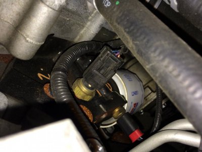

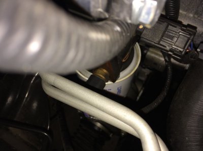

Man.. this is clear as mud. the first 3 oil changes I had done at the dealer and the filter looked like the MO-899. I did my last oil change with a purolator and I never noted the part number but it looked to be the same size as the MO-899. ( will note it when I take it off)
However.. I am gettng ready to do another oil change and the parts guy i noticed gave me Purolator L24651 which looks like the 899, however on the recipt it says "2014 Dodge Charger R/T", I looked this part number up on purolators website and it shows it for the HEMI 5.7L 09-12. the correct part number should be L12222 (for 13+ Hemi 5.7L). However the difference here is not just size, look at the difference in the relief vlave PSI on both of the filters.. I would like to see the difference of the MO-899, and MO-339 to see if they match what purolator has speced.. If I were you guys I would stick with what is recommended. I am going to return my filter for an L12222 and take Purolators word for it as I cant find any specs for the Mopar one.
Check the links out for the Purolators:
L12222 13+
L24651 09-12
Wonder why there's a difference? The motor's are not any different.
