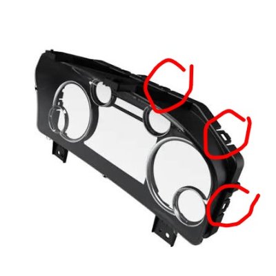

What's the process to change out just the lens. I'm definitely no mechanic.
Ken226
Mar 12, 2017
2,293
5,933
Washington State
After you remove the cluster, (4 screws in the cluster and 2 under the steering column).
6 plastic clips that you pry with a screwdriver.
If your careful you can even get them off without breaking them.
They look like this
