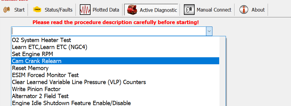

If need to to a crank/cam correlation relearn, this is it's location if AlfaOBD for Windows. I'm not sure where it is in ThinkDiag, but i'm sure it has the ability to do a correlation relearn of the crank/cam:
