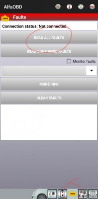

If you have alphaOBD pull codes from the instrument panel
Cruise control takes information from alot of components, ABS, PCM, wheel speed sensor etc. Start at the panel

I was going to copy the alldata procedures but sweet baby jesus, thats a deep rabbit hole. Let me know what happens after pulling codes and we can go from there
