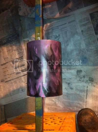

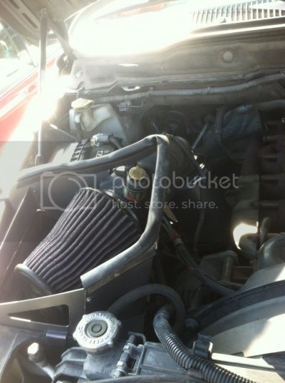

I started with and air raid cold air intake and a "custom" made torque tube that I had already color matched
Since mineral grey is so dark it didn't really stand out at all...

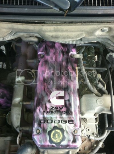

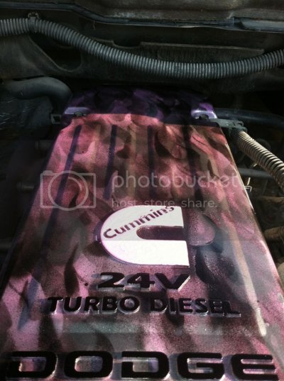

Painted valve cover

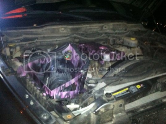

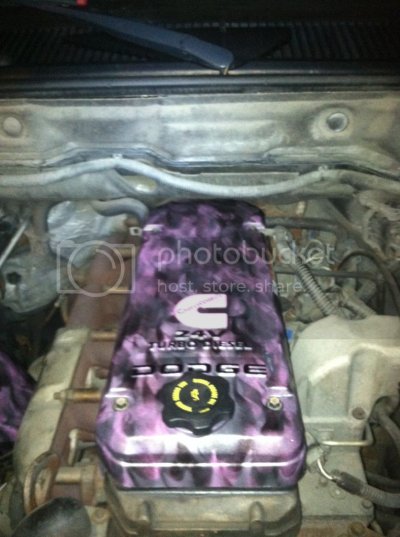

Heres some installed pictures in the dark

Thanks a lot guys! I painted it all myself, my first time trying at true fire and I'm super excited with the way it turned out!
The best part is I used all rattle can paint (duplicolor perfect match, ps2 silver, pxr brilliant black, pa9 charcoal gray metallic and ppg pure pink pearl that I had mixed) and cut some cereal box into my stencils lol
Have to thank JJ for suggestin the clear coat, it really brought the flames out and gave them depth
Braydon, I could do it for you but not for awhile. I start back at school on Monday so once I settle in we can talk about it. I have no idea what a fair price would be.
Now I just have to detail the rest of the motor and get rid of the 163k miles worth of dirt, grease an grim

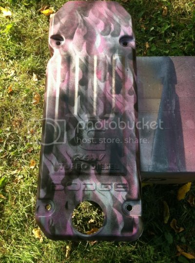

Here's some more pictures for you guys (I tried to take progress pictures but forgot haha)

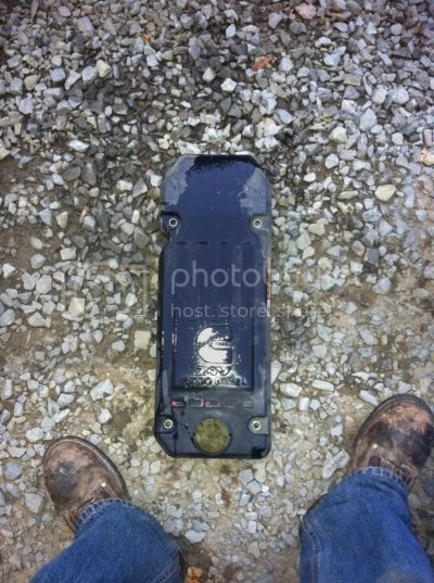

Started with this

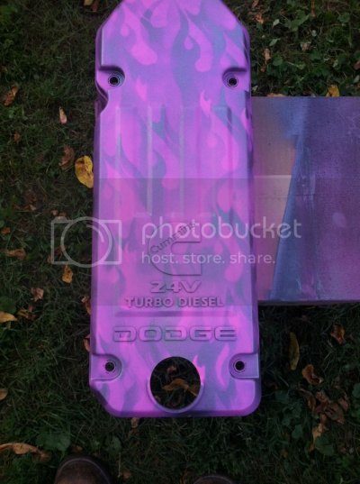

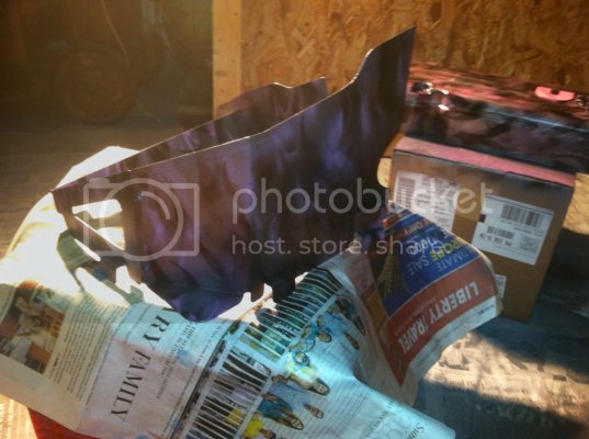

The whole thing started with a charcoal grey metallic base
Then the base flames are ppg pure pink pearl for the contrasting color

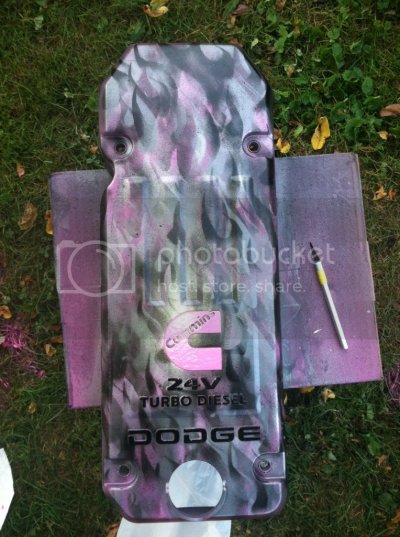

I then added ps2 silver and pxr brilliant black
Then went finished with some charcoal grey metallic flames

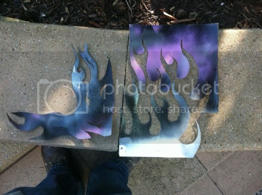

The stencils that I made, They don't have to be perfect for true fire
I used the one to the left mostly, I made the ones on the right when I was about half way done because my original had so much wet paint on it. The one to the top right really finished it all off though

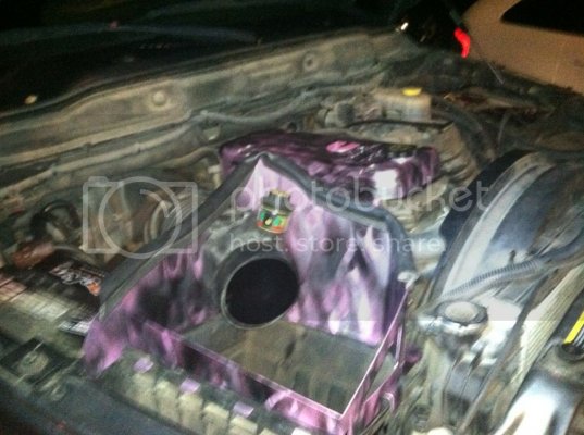

There was a little bit of light when I left
