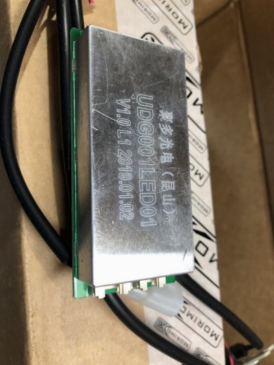

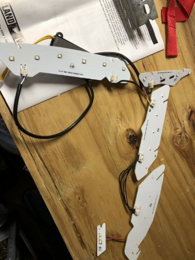

*** Can you please send me a couple photos of what the upper and lower DRL boards look like inside the ModifyStreet 2019 headlights please? Also a picture or two of the projector brackets/mounts would be amazing. Thank you.
I use a heat gun and I heat up a 3” section and I insert the Morimoto Pry tool and I break the seal of the glue, once that it’s broken, I move to the next 3” section. I repeat this until I get back around to the first spot I did. Once I’m here, the headlight just pulls apart. You need to make sure that the inner part of the clear lense has separate from the black housing section, or it won’t pull apart. I also have a few other tools I use as well, if the headlight is giving me trouble I wedge a few U shaped clips I have into the seam and then prey it apart.
There is one other driver but it's unmarked
2018 2500 6.4L

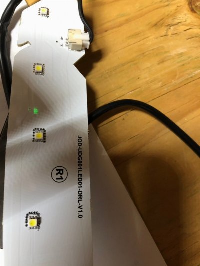

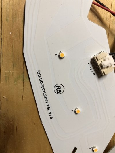

Thanks. Which boards are the uppers and which are the lower boards?
Do you happen to have any pictures of the DRL boards when they were mounted inside the housing? I want to see what they look like and what the mounting area looks like. I’ve been thinking about doing a project but needed to see what the insides look like before I start buying parts. Thanks.
Oh and any pictures of the projector mounts?

Never mind, I just realized the uppers are the white (yellow) leds and the lowers are the amber (orange) leds.
