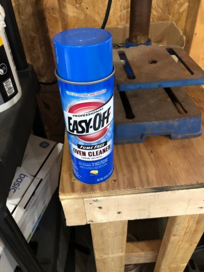

It's easy to remove the chrome of the bezels. Use oven cleaner. Within 20 minutes the chrome is gone. Then you are left with just the black plastic which as long as no chrome is left really could just be left as is.

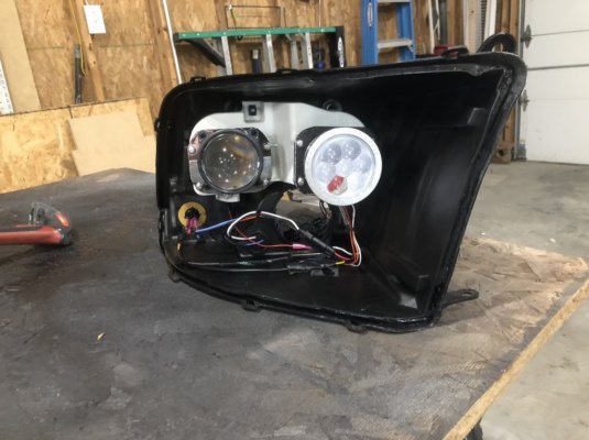

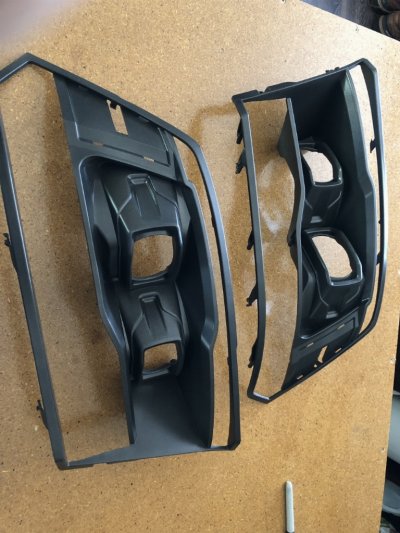

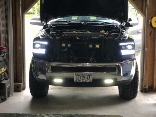

I don't have a finished pic of my headlights yet, I just finished mine. Color matched and added a few things to a set of the 2019 style alpharex/modifystreet projector headlights. Going to install them tonight, weather permitting. Here are a few pics during the process
This is what I started with
Color matched bezel
Hi-Lense Led projector high beams
Profile Pivot Led switchback strips
I wanted to upgrade the lows but just couldn't get myself to drop ~$350 on projectors/hid's kit or morimoto MLED projectors right now

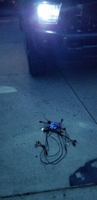

Heres an output of mine as well running the 55w kit from morimoto with d2s 4.0 projectors.

What kind of cleaner are you using. I just tried easy off and then super clean on the chrome emblem and nothing came off.
Easy off I believe. I'll double check. How long did you let it set on them

This is what I used

This is what I used
2018 2500 6.4L
Thanks, will order some. My can was yellow.. didnt do anything but make the chrome shine better lol.
Haha. Yeah a little opposite of what you want. Lowe's caries it Walmart should. Any grocery store should have it.
