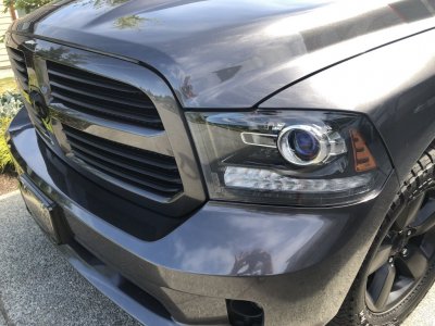

Here are mine as of right now. These started off in chrome as I have the Laramie package.

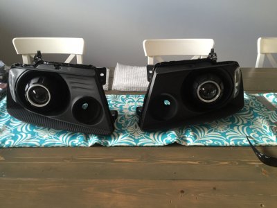

If you can afford it, I would recommend buying aftermarket replicas and opening them up. A LOT easier than dealing with the permaseal and you still have usable headlights as you build your other ones. Besides opening them up, pretty easy process honestly.
Quad Bi-LED projectors with diode dynamics switchbacks and clear reflectors.

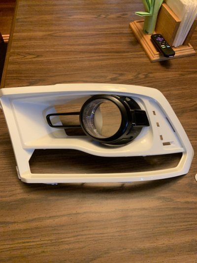

Here’s my stock:

I've wanted to do this forever, I'm just not sure how to get the paint to really work on the chrome bezel. Otherwise I would have opened them by now. I wish they just sold black bezels we could buy for these.

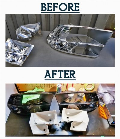

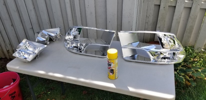

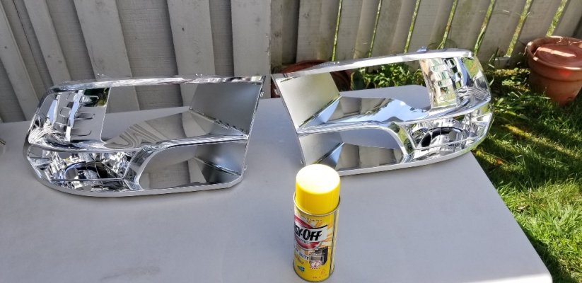

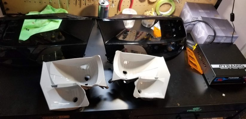

Easy Off Oven Cleaner... I bought mine at Giant food stores (grocery store on east coast) for like $2. When you spray the chrome bezels you can literally watch the chrome finish drip off as your spraying the oven cleaner onto the bezels.
It is perfectly smooth flat matte black underneath the chrome. I have pictures of the process because I run a custom headlight business so lemme get some photos of the process and I’ll upload them for you to see.
OnSale
5th Gen Crew
Nov 12, 2016
3,218
1,730
Philadelphia, Pa
37da646e5661532a2b6204867d8094c3.jpg67b5e7cec953c11bbea155a418fc1ec4.jpge9c0f04131f12122506f8ea6c4500b41.jpg9196eeddf15a24d06030e7e5848e0f92.jpg
You can see the easy off oven cleaner can in the first 2 photos.
The pictures where the chrome bezels and the reflector bowls are “black and white” is what they look like after using the easy off oven cleaner to remove the chrome. The bezels turn matte black and the reflector bowls turn a gloss white.
All you need to do is remove the chrome with the oven cleaner and then just rough off the surfaces of whatever you want to paint with some 1000-1200 grit sandpaper and then they are ready for primer/paint.
Any more questions feel free to PM me. I have tutorial videos on how to dremel the reflector bowls so the projector mount threads can fit through the bulb hole without over-dremeling the hole and having issues.
Good luck man.
