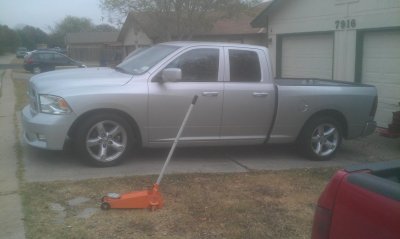

cut my springs on friday. left the notes at friends shop but from what i can remember.
before front : ground to fender 36"
after on front before settling: 33.25'
2.25 coils cut from bottom
rear before 39.25" pass and 39" on drivers
after both : 36"
driver side 2.5 coils cut on drivers and 2.75 on pass
factory tires rub on big bumps so i put on my 3rd gen's wheels w/ 30in tires till i can get my tires swaped
