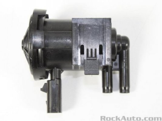

Fuel filter and pump is all one assembly in the tank. Yes I agree with running near empty, just got lazy lol. I have been battling an evap leak for awhile. I replaced the leak detection pump but still get codes. The p0452 happened right after the refueling incident. Hoping its related to the fuel pump.
Typically that is a vapor purge solenoid and it is located on the driver side front of the engine bay on a 2006 and I believe it is on the same location in a 2004.
NovaDenied
Mar 29, 2019
6
Virginia
Thanks LoneWolf, I'm getting my fuel pump replaced tomorrow morning and I'll ask my mech to get one for me and see if that helps.
