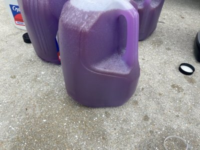

Found my pictures. Old coolant in bucket. 50/50 with distilled in the gallon jug
