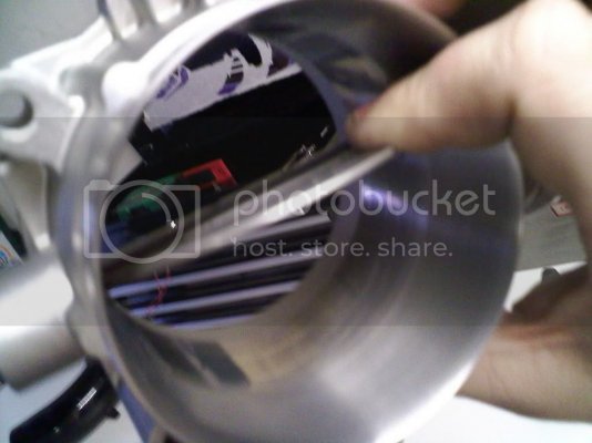

does it have a knife edge on the plate? I had one from fastman with the knife edge and it would lunge forward to the point it was dangerous to drive in stop and go traffic, was a nightmare actually. Swapped one with the regular plate and it worked better as long as the throttle sensitivity on the Diablo was turned fairly low.

they use a stock blade, he just grind the blade out the butterfly plate to a "sharp" edge to allow a more instant go, but mine jumped and bucked and lunged forward. Check and see if the plate has an edge, if it does that may be your issue and he practically welds the plate/ screws in there, have to heat the screws up before you can try to remove them and that makes them very easy to strip. I sent mine back and had him send me a new one, just paid shipping.
truckin151
Jun 29, 2010
5,712
257
Arizona
2013 sport
beveled "knife" edge

it's really hit or miss, there are a handful that work fine but from what I had been told by then they get more complaints and issues with the knife edge than they did with the regular plate. It IS the stock plate, they just modify it for the knife edge.
