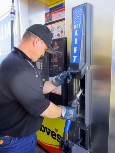

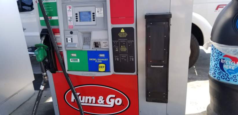

Only stations that get several deliveries a week, like major Truck Stops, can afford an Underground DEF Tank
LOVE'S Truck Stops all have DEF at the pump
Hidden DEF Pump Nozzles
