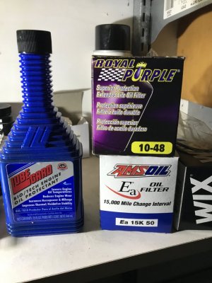

Hey yall so new ram owner. 14 5.7 with MDS. So for my next oil change i should switch over to redline 5w30 and RP filter?
redline 5w30 is better then redline 5w20 in our trucks/?
If i run mobile 1 5w20 with lucus stab that is fine in my truck with MDS i saw some threads people always mentioning they run lucas in a NON mds engine.

Look up lucas stabilizer stat sheet, the viscosity at operating temp is over 100, 5w20 that number is 9, 5w30 that number is 12. With what we know about hemi's, this product should be nowhere near it. If you believe machinelube the perfect balance of protection and flow is somewhere around 30 weight. Research around a bit and decide what you want. I run 5w30 redline, but I also ran 5w20 redline with great results. If you don't have any tick, Pennzoil PUP and some lubegard biotech looks like a great option. Lube gard biotech is poor mans redline, it is built like redline, so you can add that to your favorite oil and make it better for the hemi. Molybdenum is the real beneficial additive.

Great thank you for the info.theres no tick but I want the truck as long as I can make it and treat it well.
For a 14 raM a 10-48 royal purple filter is correct?
What's the next best thing if I can get a rp

You can opt for larger RP 20-820 if you want, many guys run that. Fram Ultra, Wix XP, Napa Platinum, Amsoil EA, SRT filter, are all good spun microglass options. If you have time read filter thread in my sig.

That rp 20-820 works on the 2014 cause its saying it wont??

So been searching around for redline, found one place in canada with the 1 gallon jugs so 3.85 liters or so and its $65 bucks. Or 1 quart $20.. Plus shipping of course.
Then the RP filters found $33 each lmao.
the lube guard. Cant even find out here or online just no luck at all..

People keep pushing old tech RP filters. Get these:
https://www.pureoil.com/en/do-it-yourself/oil-filters/purolatorbossr/

I order from a new place I found out in Quebec for redline. They carry the stuff for everything you’ll need for your truck. RP filter I get off amazon Canada. She’s at $32 right I believe and I have searched for this everywhere! Ebay Canada has them too, but you paying more for duty/shipping. Partsource offers redline oil as well. They don’t advertise what they carry, just a few items. They don’t advertise the redline motor oils but have them in stock. It may depend on your local Partsource store too as I heard some don’t keep it in stock or carry at all. I know the Timmins parts source here in Ontario carries it. The dude at the counter always asks why I’m running this stuff as it’s their most expensive oil they carry. My answer is “My lady loves it” lol.

5w30 or 5w20 you been running? Im in the middle of nowhere out here but the partsource an hour from here only carry a couple redline additives and no oils.They said no one has enough money to use it so it sits too long.
Asked them to get me and they said they cant there system wont allow it haha.
