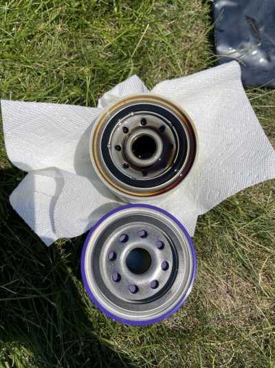

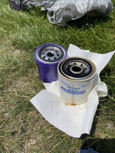

sorry I didn’t get under there but I think you guys get the just. I took a couple pictures of the old filter and new one before I put the rp one on. Any thoughts on the oil pressure gauge running high when the rev’s are high? At idle it’s dead Center. Hopefully this works but if it doesn’t part of me feels that maybe it’s a warped manifold and not an internal tick?
Did the noise in engine change at all? I really think it is lifter tick if it is the one I am thinking about. We will see in 500 miles partner, that is what it took for mine to go quiet. Oil pressure goes up with gas pedal, if you feel so motivated post your psi at 2k rpm, and 3k rpm, and when I get a chance I will do mine. 5w30 redline made my psi go up maybe one or two over 5w20, in other words next to nothing.
