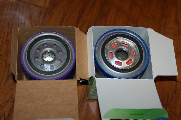

Burla
Burla
Apr 28, 2012
27,743
58,186
2010 Hemi Reg Cab 4x4
Constant warm idle tick like the engine was being choked from oil. I would mention the brand, however they have sense upgraded it, so I will leave it alone.
If you zoom it you can see why, the rp on the left had a bunch of holes but the other filter on the right did not, prevented good flow, and it showed up as tick.
