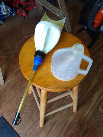

Just to help out you folks who are doing your own oil changes at home. I use an used/empty plastic half gallon Clorox bottle that I make an cut out for catching the oil from removing the oil filter. I place it under the oil filter above the front frame support and break loose the filter and let it drain into the oil collection pan. I bought an oil filler funnel with an on/off spout and tube at my local AutoZone that I can remove and attach just the on/off shut off with the tube to my plastic Clorox bottle and direct the oil into the pan without the oily mess all over the power steering assist boot/frame.
