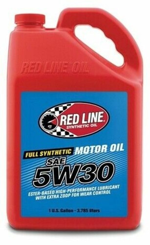

When i priced it out on Amazon,with shipping,it was almost as cheap at Mopac. You'll need 3 quarts extra. A gallon these days is only 4 quarts or 3.78L ,and your truck calls for 7 quarts. It'll make your **** tighten up,to do a Redline oil change with a Royal Purple filter in Canada,lol

Not much cheaper then either Mopac or JB's on Amazon.ca. The 12 quart pack has free shipping,but check out the shipping price on the gallon jug,that puts it above the cost of buying it at the local speed shop.
The gallon jug actually ships from JB's,lol. It probably ships from their Edmonton warehouse

Ebay has it cheaper, but 4 day wait.
That's 54 bucks US,not Canuck,so Ebay is noticably higher then Amazon.ca once you convert it to Canuck bucks,and factor in the shipping

i figured 7 quarts is 6.62 litres. So I thought A 1 gallon jug and 2 would be enough but your right I’d be short 1, math was off might as well hit Mopac for it on Saturday
