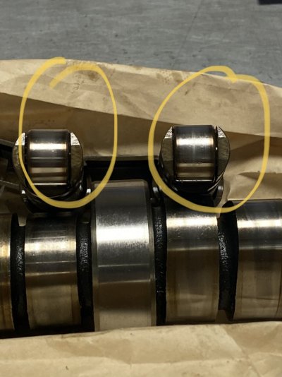

So I got my truck back, new lifters, cam, new water pump, gaskets, cleaned heads all that jazz. Seems quieter but not completely gone, there is a note on the bill that injector tick can be heard at idle, no faults just a noise. Ride is silky smooth and good power it feels brand new. Inside the cab you hear nothing, it’s when you get out that you hear it. Here’s before and after videos. Also I got pictures of the old cam and I got them to give me the old lifters but all of the rollers seem in tact to me? Did I get hosed into this $6500 job? I’m not sure honestly. Does the new cam and lifters need time to break in maybe? Should they have replaced the injectors at the same time?

I wish you would have trusted me, I've seen this on the board too many times, and that cam has a little grove starting but that thing could have lasted a lot longer. IMO it's your job now to start a thread and let people know, just because you have hemi tick getting new lifters before a mis fire code may not be the answer. I would not say you got hosed, they performed the job you asked them to, and of course they have a solid position and concern with evidence. Help the next guy man.
So now we should start a new lubrication strategy yes? Your tick is not terribly bad, not the cam eating ticks we sometimes here, but not injector tick either. Moving forward, I would want ep additives protecting the new parts, base oils as well.

I can't hear well anymore so I won't comment on the audio.
But I can still see well, and it looks to me like the old cam definitely had a smear pattern going. That indicates sliding wear, not rolling wear. Rolling wear is fatigue pitting. Siding wear means the lifter roller is seizing up. So yes, you had the Hemi tick.

Bottom line, hemi tick does not come from bad cam/lifters, most of the time it comes from a condition other then that. The exception is when you see pitting in the cam from bad rollers, but that is a rarer event then this cam lob smoothing we often see here. So if hemi tick doesnt come from bad cam/lifters, why do we think replacing cam/lifters would stop the tick? The damage to the cam/lifters come from hemi tick condition, but do not cause it. Time and time again, we see this.

You didn't fix nothing, you fixed a damaged cam from hemi tick, it just wasnt fatal yet. I don't know why this shop has so much credibility with you, clearly you had no engine mis fire code and yet they spent a lot of money. I don't blame them, any shop would do the same thing, perhaps they should have warned you like I did, that is what a credible shop would have done. This is not the first case of this and wont be the last. Normally I suggest litigation, but in this case I'm not sure what they did wrong other then not tell you hemi tick can still be there after a cam swap. You not only tried to fix your lifters/cam, but you were successful in doing so. Now, it seams to me all you can do is despite having tick, put as much protection down on that cam as you can. I think redline 5w30 and rp is the way to go, extend the interval out well past 10k miles and 3/4 through the interval drop in bgmoa for tbn insurance. So the 140 is more like split in half because you safely increased the life of the oil. up to you brother, I have just have whatever info you want, if you want cheaper we can do that as well. take some time, lick your wounds, and move forward.
