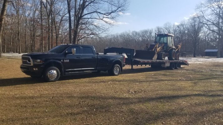

Who can let me try out there gas truck? 5th wheel required. LMK.
trailer empty - 8,200
Hoe - 17,900
I get 11.5 mpg towing this combo. Diesel by me is 3.97. Gas 3.25.
So what will your gasser get towing this? If it can. 7, 8 mpg? 6?
