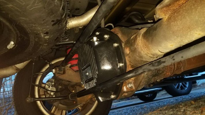

Looks great, this has been on my list of things to buy/do. What did you use to seal it?

Oh ok I did not know that, I assume the bolts don’t have thru holes so nothing needed on the threads either?
That's correct they are just bored into the case of the axle and are not through holes. I opted not to put antiseize on the threads because the bolts that come with the MH cover are stainless.

Last question....TQ for new bolts?
The MH instructions say 16ft/lbs which is 192in/lbs. My big torque wrench doesn't go below 20ft/lbs so I used my small in/lbs torque wrench at 192in/lbs.

I do and I don't.
It's really nice to be able to fill it from the top without a pump. The Redline quart bottle almost fits inside the dipstick port so that's really nice. Plus the dipstick has a small magnet on it.
But it makes it idiot proof to fill it until the fluid comes out of the fill hole on the factory cover. With the dipstick it makes it a little more trial and error until it's at the right level. For me it was 4 quarts exactly.
I checked the dipstick this morning and it was exactly in the middle of the two marks on the dipstick. Last night it was above the full mark. I'll probably check it again tomorrow to be safe.

A closer look at how close the bar is to the MH coverec5034e66ac193d454560221b4bee0bc.jpg

I do and I don't.
The level will fluctuate a bit as some of the fluid ends up down the left & right side axles to the axle shaft seals . I'd say anywhere above the minimum line and your fine ....me personally I might would drive it 10+ miles to heat the oil a bit ( expand ) , then park on level ground then check it and adjust as required .

Yeah that's probably what happened, it flowed into the axle tubes. I checked it again this afternoon after driving it for 25 miles on the highway. It was about the same level on the dipstick as this morning.
On a side note the magnet on the dipstick is strong as hell! I was pulling it out the check the level and stuck to the panhard bar.
