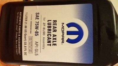

I'm getting ready to do the first front and rear diff's and transfer case fluid changes in my '14 1500. It's the Express model with the 5.7 V8, 8HP70 8 sp trans, the BW44-45 transfer case with conventional differentials front and rear. Can anyone offer any insight as to why when the dealer looked up my vehicle's VIN it called for special frnt diff fluid, Mopar #68083381AA. At $56 a liter I have a hard time believing that there is something so unique about this frnt diff that it requires this special gear oil. As the bottle states, it's for a ZF electronic limited slip diff assembly (ZF-ELSD). But to my knowledge the build sheet says the diffs are conventional and I've never heard of an ELSD in the front diff. Thanks.

yeah, crazy expensive was my thoughts but searched extensively on the internet for justification to use something else and not much out there about this fluid and any safe alternative. I have the lifetime warranty on this vehicle and don't want to jeopardize it by not using factory spec'd fluids or a verified alternative. the dealer stated my frnt diff requires 1.1 qrts which this bottle is a full liter (1.06 qrts). hoping there's a Ram mechanic on this forum that could shed some light on this mystery. Thanks.
