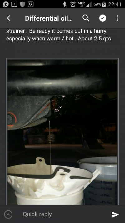

So I'm sure this was answered; and I read every post, it's getting late. Lol. Good stuff! RLK I have a 12 with the same rear diff. No owners manual because of buying it used. How much fluid did you use in your rear diff? I ordered my Redline tonight and plan on doing some maintenance this weekend. Thanks!
Here ya go Sir , from my post #1 here
The container in the background is a 2qt container ....I actually drained out about 2.15 qts , however when I serviced it back up to spillover I pumped in about 2.5 qts total .
