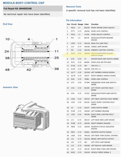

You would install a simple two wire switch on the tailgate handle switch sense wire, and the only spot to do that inside the cab is grabbing that wire right at the BCM. The BCM is mounted up above the brake pedal. It is the green wire with white stripe in pin number 8 of the C6/F connector. There are 7 connectors plugged into the BCM, and are labeled on the housing A-G. 2lllSOz.jpg
Obviously, doing this would mean anytime you want to open your tailgate when the truck is locked, you’d have to unlock the truck, open the door and flip the switch, then walk out back to the tailgate to open it.
Thank you! That's excellent information! I'll take a look and see what this entails as far as cutting and splicing. I will admit to being a bit squeamish about cutting into a factory harness as it can get expensive if I short something out...
And yes, the procedure you mention about having to get into the truck to activate the switch is exactly what I had to do previously on my 2019 Tacoma (sold to fund this truck). As Tacomas didn't come with power locking tailgates, I installed a "factory looking" pop and lock I got off Tacoma World forum that used the passenger door harness. I inserted my own kill switch in this aftermarket harness so I didn't have to cut/splice the factory harness. Worked beautifully!
I may still try going through the switch in the tailgate and installing a waterproof toggle in the bed... We'll see.
Thanks for ALL of the replies!
