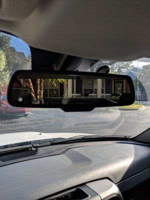

I can now verify that harness 68207372AB does work with the 2017 mirror 68293658AA. I don't see any reasons it won't work on any other 2017 part numbers.

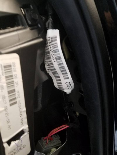

Placing this info here temporarily...
Here's the mirror header harness info from my 2018 Ram 1500 Laramie w/AutoDim & Humidity Sensor (for ATC) ...
18 AutoDim Mirror Harness (no mics) W/humidity Sensor (atc)
- PN: 68343002AA
