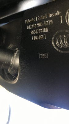

My friend just found the difference.
1500
68096094AF
2500/3500
68342284AA
But BOTH say With auto dim, with uconnect, with smartbeam.
1500
68096094AF
2500/3500
68342284AA
FYI,
68342284AA is the PN of my Factory smartbeam mirror on my 18 ram 1500 Laramie. (68096094AF is an earlier year PN, ie 13-16 mirror with mics) see post 1

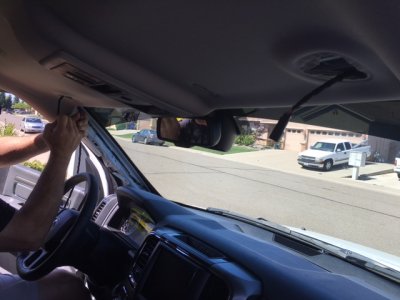

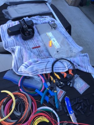

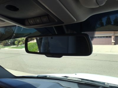

Rick "Ricks-Ram" did my Mirror install for me a few months ago. Also installed my two new lighted Sun Visors at the same time. I got the mirror with the Smartbeam option, this is a very cool option to have. Worked great on my trip to Reno and back. Thanks again Rick for the hard work!
