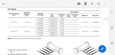

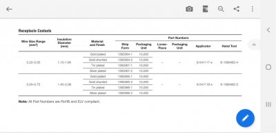

I got info back from te, thanks to you
The mating connector for TE Part # 1456989-3 is TE Part # 1438170-1. The terminal Part # will depend on your Wire Size. Attached is a catalog for this connector series. You can find the Receptacle Terminals/Contacts on page 22 and the Pin Terminals/Contacts on page 23. These pages will also show the tooling that is suggested for the connectors as well as additional technical information/features.
Hope this helps, now you can make a harness so the aux buttons address all plug and play , so no permanent mods during install

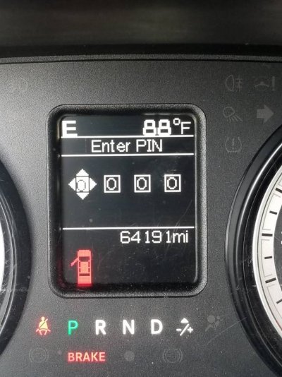

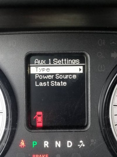

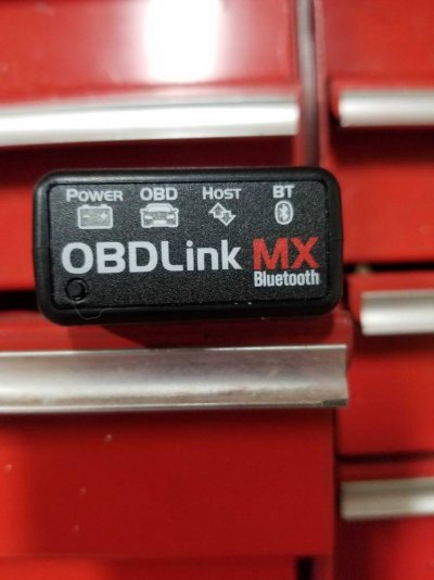

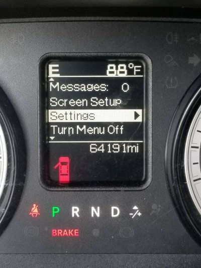

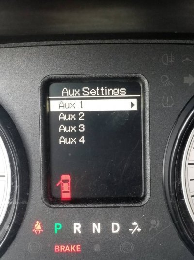

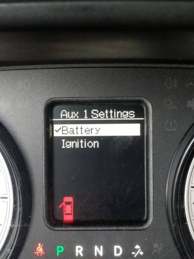

Update: When I installed my Aux switches orginally, switch 1 and 2 would function with the ignition off and 3-5 required the key to be in the on position. I recently picked up an OBDLink MX 426101 bluetooth scantool on Amazon and then purchase the AlphaOBD app through the Google play store for Android. Using the Alphaobd app with the OBDLink MX, I was able to access the body computer and enable the Aux switch features. Now I have control to designate the switch as momentary or latching and choose if it is battery or switched powered through my EVIC.
As a side note I was also able to enable my DRLs using the Alphaobd app with the OBDLink MX and choose which lamp I wanted designated as the DRL. I'm still exploring other enablement options.

The OBDLink MX works fine to use with AlphaOBd? Don't need the MX+?

The OBDLINK MX version worked great. I did not need the MX+ce075b2f1a20f933164e68475011c897.jpg

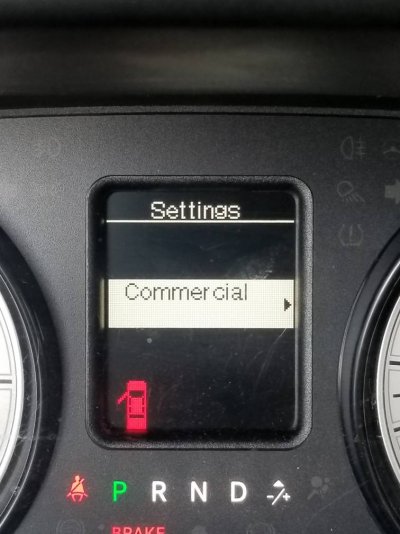

Finally finished installing these in my '17 2500 last night. Only problem I am having is the Aux switch CSM doesn't show up in my radio (it shows up in my 7" cluster under the commercial settings though) and when I go through the commercial settings menu and check the "last state" of a switch it pops up with an error, says something about checking the owners manual.
It is also possible to get everything from a OEM setup and wire it like OEM (you could add a PTO this way as well), I'll take some pictures and get a list of all the terminals and connectors I used if someone is interested in doing the same.
